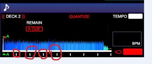

Hello, I would like to create, as shown in the image, small lines that correspond to a mark of minute 1, minute 2, minute 3 etc.
I show them my code and I would like it if they can help me with a better solution than mine.
What created the following code of Slider in which it locates the brand in a parellel way to the songpos which will show me the line in minute one. In the next step I indicate how I do to mark in that position.

Hola quisiera crear como muestra en la imagen pequeñas lineas que corresponderian a una marca del minuto 1, minuto 2, minuto 3 etc.
Les muestro mi codigo y me gustaria si me me pueden ayudar con una mejor solucion que la mia.
Que creado el siguente codigo de Slider en la cual ubica la marca en forma parelela al songpos el cual me va a visualizar la linea en el minuto uno. en el siguiente paso indico como hago para que se marque en dicha posicion.

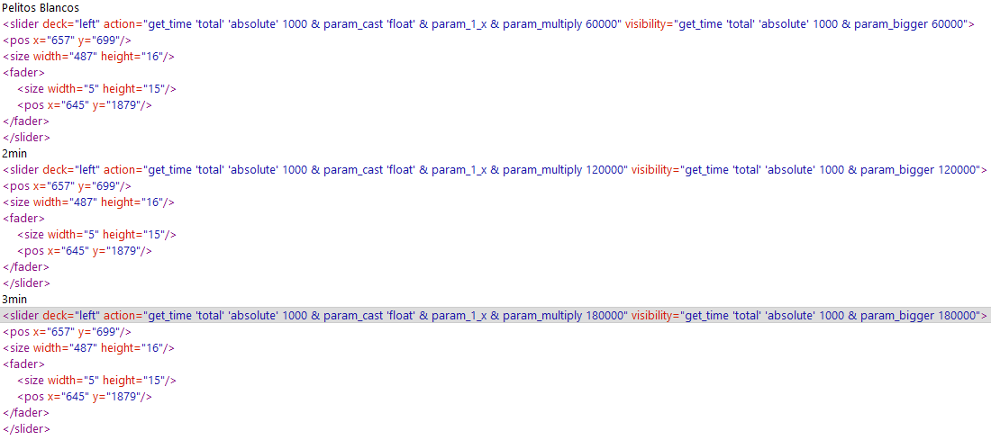

NOt Working :(
tengo esto pero todavia no Funciona.
Posted Tue 27 Feb 18 @ 1:36 am

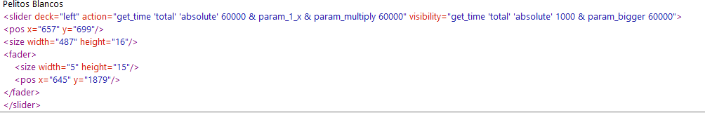

First of all your action is wrong*
Second, there's currently a small bug in param_1_x action that may prevent this from working properly, but it will get fixed on next build
The action should be
get_time 'total' 'absolute' 1000 & ...
Posted Tue 27 Feb 18 @ 9:35 am
Instead of ..
get_time 'total' 'absolute' 1000 & param_1_x & param_multiply 60000
try ..
get_time 'total' 'absolute' 1000 & param_cast 'float' & param_1_x & param_multiply 60000
try ..
Posted Tue 27 Feb 18 @ 1:43 pm
