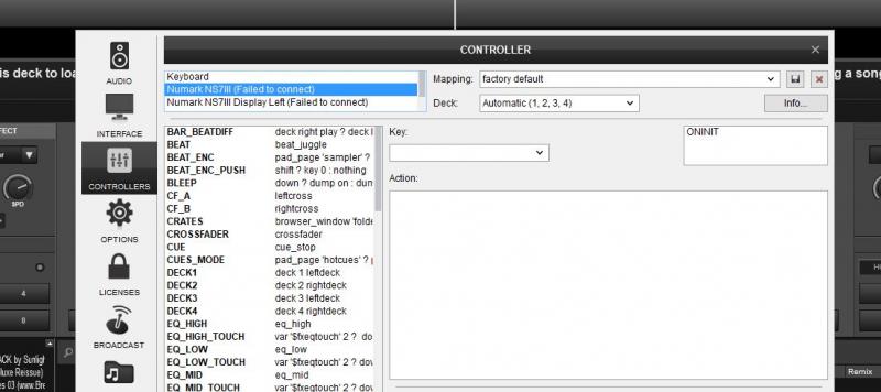

I recently purchased the Numark Ns7iii. I plugged it into virtual Dj 8 and all worked well but my no sound from headphones. Ended up downloading new drivers and reinstalling VDJ software and now it won’t recognize my controller. I do have the pro subscription and my computer is more than capable to handle the controller. The computer itself recognizes it in the USB ports without any errors. Any help would be very much appreciated.

When first connected, one of the the drivers didn’t install correctly. That’s why I had downloaded and and updated the drivers. When I connect to the software nothing happens with the controller. At all, no screens, no faders, no platters moving, nothing. When I go into settings on vdj it says it is not recognized.

I have an NS7 iii too and I have used it for a year with relatively no issue. Going to need some info though. Lets start with do you have Mac or PC? Looks like PC because of the X on settings, but not having used Mac I have no way to confim that.

Your issue is not related to VirtualDJ, so re-installing wont help.
Issue is from Windows that for some reason can not see the unit as MIDI. BTW, the drivers you downloaded and installed are for the screens and the ASIO, nothing to do with the generic Midi functionality.
Just to confirm that Windows cannot see the unit as MIDI, you can download MIDIOX (Google it) , select from Options-->Midi Devices and see if the NS7III is there and can be selected.
there could be tens of reasons why this happens.. my personal advise and experience on these matters, is that resetting/re-installing Windows will probably take less time than searching and trying all kind of things.
BTW, what Version /Build of Windows are you on ? (Right-click on Start-->system). Any chance you are on the latest 1709 ?
