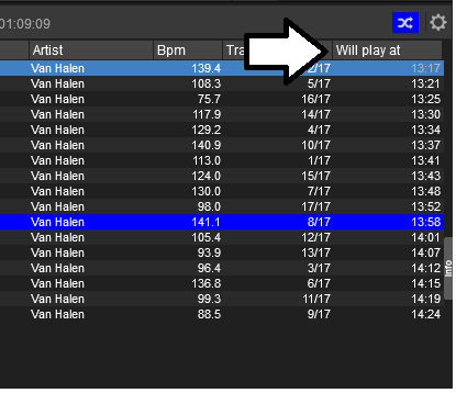

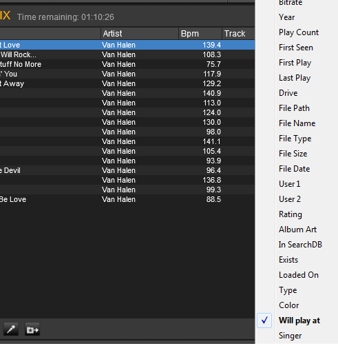

hi,
if you are going to use the Automix, select the column to view option, will play at,
then you can insert your song
good luck
GK
