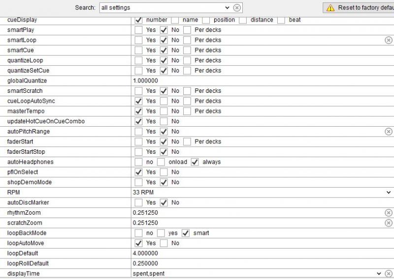

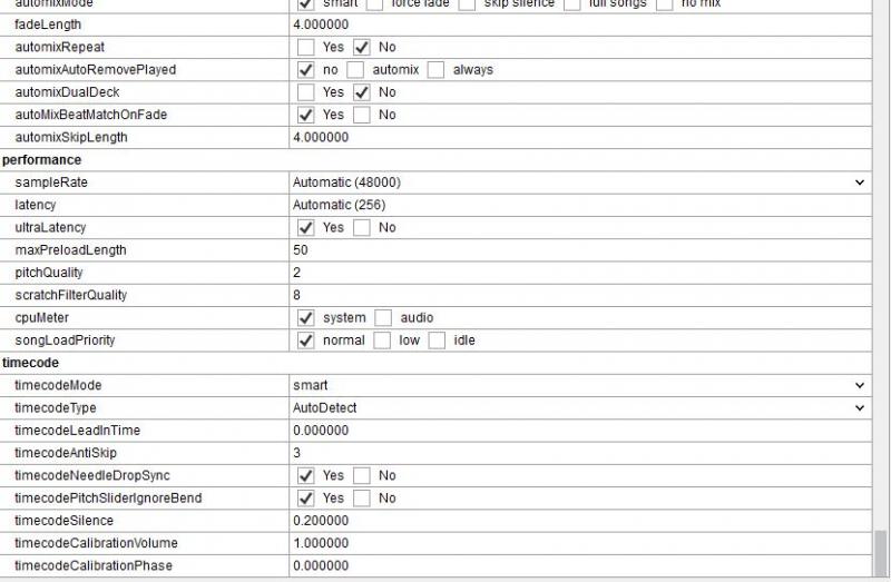

Hello @djcel,
I've sent you the snapshots you requested with the INFO.
Yes I do use Mastertempo, but never had an issue with it.
I only use songs with a smplerate 44100 and always had the setting at 44100, but now I noticed that it's on 48000.
Also, I saw Ultra-latency on "Yes", when I always had it on "No".
Latency is at "256" I think that's normal, default setting.
The rest of the Values you can see them on the snapshots.
Could all these Values have changed when installing-uninstalling drivers or when using the Audio 2 mk II ???

On my other Laptop, where I haven't connected the Audio 2 mk II (Lenovo), the Latency is Set at 512 and the Sample Rate is at 44100, where I always have it set.
But on my HP Laptop, the one I used this device, Latency is at 256 and Sample Rate at 48000.
As I mentioned before, both Laptops had the exact same settings in V DJ and now they differ ...!
Can an Audio Interface, just by connecting it, change the settings on it's own ???
(This has never happened with my other Audio Interfaces)
and if yes, by saving different configurations for each Audio Interface that I use, will the settings Change (be different) each time I change a configuration option (automatically) in the Audio Settings ???
I've also noticed that Ultra-Latency is activated "yes" on both Laptops, does this Option activate only if you are using ASIO Drivers ???
Because most of the crashes occur when using the Laptop's built in Sound Card.
Posted Sun 13 Aug 17 @ 10:56 pm

Latency at 256 instead of 512 and Sample Rate at 48000 instead of 44100.
Can an Audio Interface make these changes by itself ?
and if Yes,
by using different Configurations in the Audio Settings for each Interface (Config 1, Config 2 .... Config 4), can the Options-Settings for each Config be different ???
In other words, can the Values-Settings in the Options & Tweaks be saved differently for each Config in the Audio Settings separately ??? So that each time we use a different Audio Interface the Settings change automatically with it ...?
This would be very useful ...!
