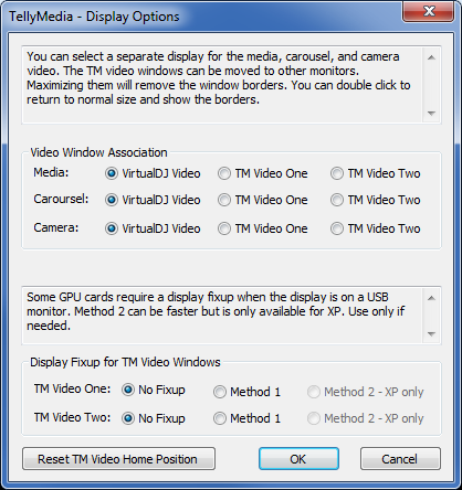

With the TellyMedia Plus version you can send it's Media, Carousel and Camera to either the VDJ Video or 2 optional windows. When sent to an optional window they are independent of VDJ's display mechanism.

4) adds 2 more separate display windows in addition to the VDJ display window. You can set TM's Media, Carousel, and Camera displays to be on any window. The windows can be moved to any display you might have.,

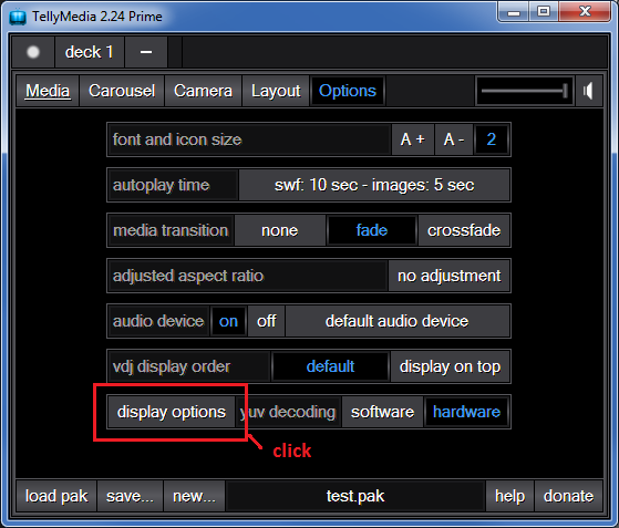

How to do it? What else do you need? I have the plus version

Posted Sat 29 Jul 17 @ 11:50 am
