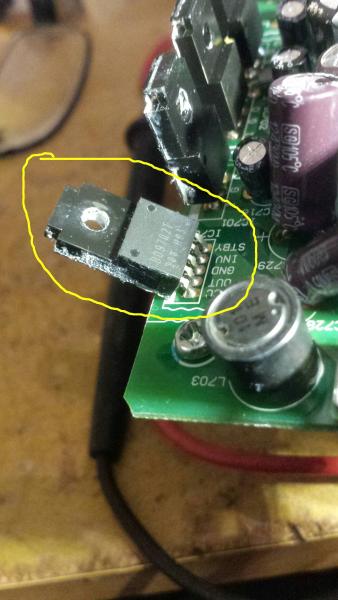

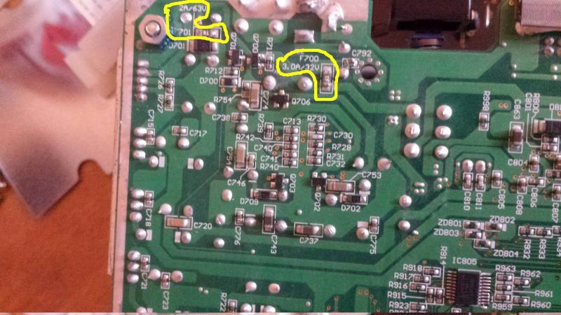

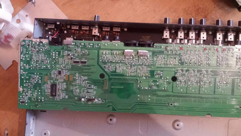

While setting up I plugged my laptop power supply (19v DC) into the MC6000 (12v DC). Wish it had been my MC3000. Anyway I've given up waiting to pick up a second hand battered MC6000 for spares so have started to attempt a repair. Here are a few photos of the MC6000 showing the IO board. In yellow I've marked two fuses, and voltage regulator. The fuses are OK and the voltage regulator is my main suspect.

Have you tried looking up that regulator part (I can't read it from the pic)? I would've thought it'd have wider range / tolerance of input voltage than to die from an extra 7 volts.

I have a service manual for the mk1 MC6000 (MANUALS LIB-erated!) & I think transistor Q700 is a likely suspect. It has a maximum drain source voltage of 20V & it switches the power rail to the unit before the main regulator.
