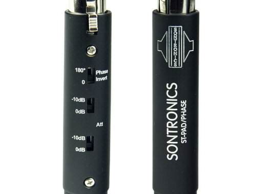

Easiest way to solve the hot mic issue is to get an in-line attenuator to lower the input by 10db. Works a treat with the MC6000

I find turning theVDJ master down to half is easier than plugging in a massive great big attenuator :) I don't like riding the gain on the faders.
