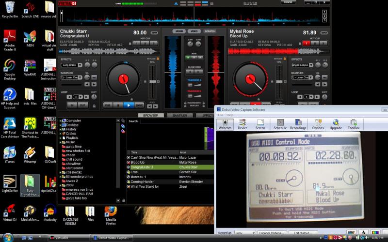

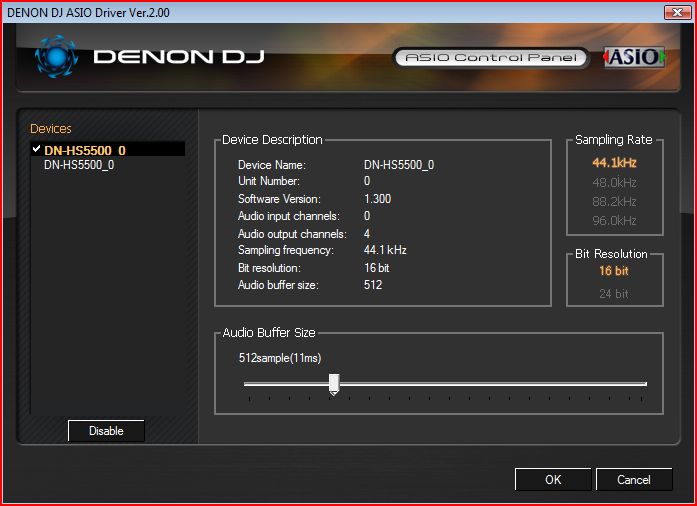

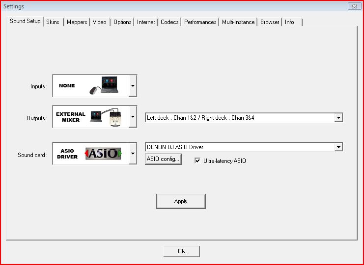

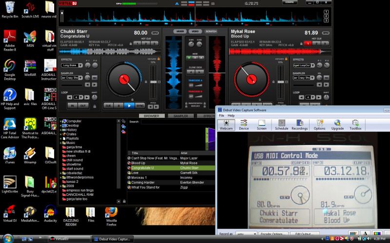

Just take some screen shots of your configuration - Denon ASIO control panel, VirtualDJ Config -> Sound card setup.
money grimes
Professional edition user
Posted Thu 10 Sep 09 @ 7:32 pm
aiso
sound card sset up
right side
left side
like I said I can see both side on each of the screens of the denons, but I notice, that If for example I have deck a controlled by left denon and deck b by right, and the sound is coming from the left denon, if I press the payer button, I can control the right deck with the layer 2 of the left deck. Is that normal, sound I not be able to do that. I have tried changing the usb ports and it does the same thing

Ok, in the Denon ASIO control panel - did you Disable the second 5500 that is listed ?
Also, are all your RCA connections going from 1 unit to the mixer - or do you have 1 RCA cable from the left unit and 1 RCA from the right unit
Since you are using 2 units you should not use the layer button - it is doing exactly what it should - switching control from left deck to right deck - but the layer button has nothing to do with where the sound comes from.

***************solved**************
what i did was open, the aiso config; then I double clicked on both hs5500's so both had a check, then I disabled one. Don't know if this is just my setup, gonna keep playing with it for a while. thanks again for the help
